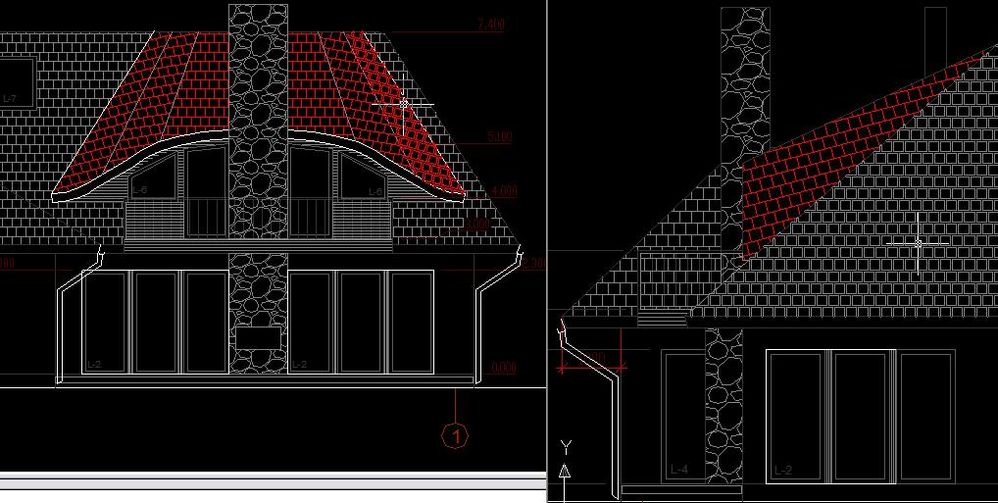

Hi all , i'm new in archicad 10
i was working on autocad and i have one project, i wanted to create 3D in archicad but i don't know how to make a roof on it.. look at the picture.
Thx for helping.

using the Skylight tool you could try creating a 'quick and dirty' solution using the 'Dormer Ox-Eye 10' skylight object?
for a more accurate solution that you can pull decent sections from you would need to place multiple roofs and intersect them - being sure to create holes in the original roofs. then use a trimmed-to-roof wall to put the window in.
one is a visualisation element, the other requires you to build it virtually as you would in reality. the virtual building solution will give you better longer term options but require a thorough knowledge of how it's constructed in order to build it yourself.
depends why you're producing the model . . .
HTH
