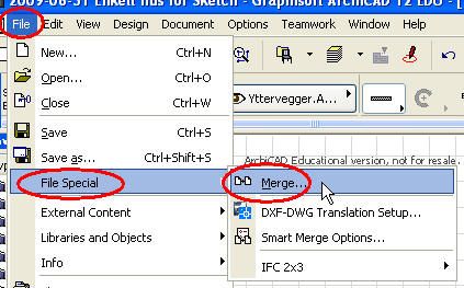

It may be problems in your ArchiCAD file. Personally I prefer to make use of the Merge function in ArchiCAD. Open a NEW unused ArchiCAD file. Choose File - File Special -Merge in the NEW file and then choose the problem file. This is to to "adjust" the problem file. (From one of my books on ArchiCAD)
Good luck!

It is even better to merge into a blank started from your template file, as all the settings should be as they are ...
