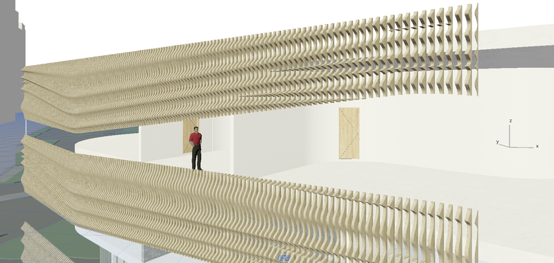

Hi!

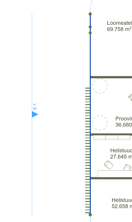

Can you tell me why this space is there and how can I fix it? In the plane it is correct.

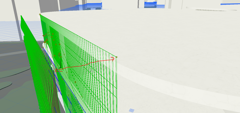

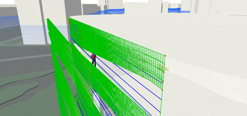

It looks like it is an issue of why the 3D curtain wall is offset away from the reference line.
@Ivika , do you have custom frames or panels?

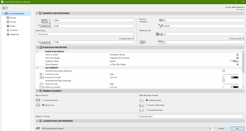

I see the offset from reference line is zero (0).
But it is set to measure to 'Panel Center' and your panels do not look flat in the image.

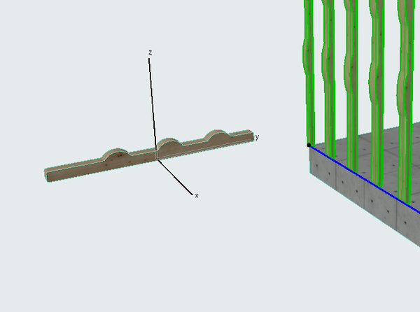

I created a custom panel to generate a parametric facade. That's why the panels aren't flat. The strange thing is the gap between the 3Ds panel and the wall, and I can't seem to adjust it. Whenever I change the offset in 3Ds, it messes up the alignment again, and I can't figure out why.
Hi @Ivika
Check the position of the original geometry you created for the object. It should have 0 elevation.
Anyway there are some options within the curtain wall panel settings that you could play with.
