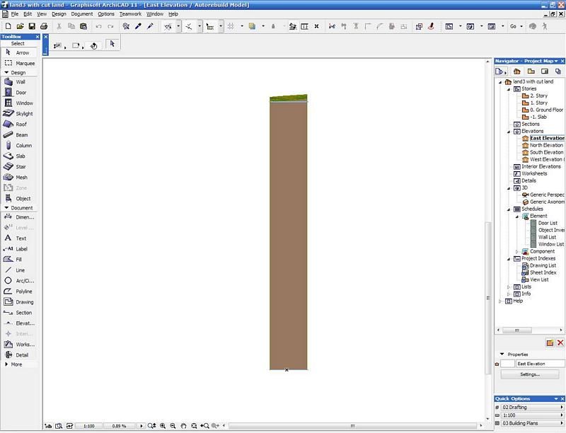

I have some troubles to drop the land's height, i put in the details of my land, around 173000 in height,
Wat i did is, i go to 'view'--> 'element 3d view'--> 3d cutting place' draw a line trough the land, then activate '3d cut way'. I can see the height of my land is dropped in 'Generic perspective' but not in the 'elevations'. what steps am i missing?

The 3D cutting planes only affect the 3D window and views derived from that. Section/elevations are separate and each have a setting for top and bottom of the section cut.

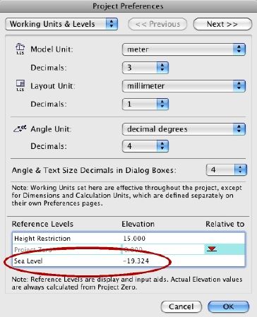

This is a neat trick also but not quite what I meant. If you set one of the two reference levels to sea level (relative to project zero - see attached) then you can simply adjust the mesh elevations relative to that reference level.
This saves having to do the somewhat counterintuitive negative thickness and eliminates the need for a sea level story height. In fact it separates the whole issue from story settings altogether.

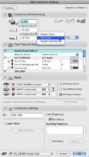

Here is the mesh settings dialog showing the height to sea level option.
