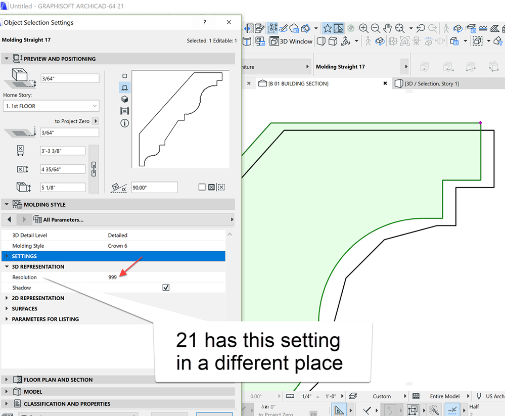

Steve Jepson
notice that with the molding library parts you can set the resolution to 999 or what ever to make the curves of the molding a smooth as possible.
If you make your molding into a library part you could add a RESOL script like the one in the Molding Straight 21 and Molding Curved 21 have. I don't know exactly how to do that but it should be possible to get smoother curves by using some GDL scripting.
no reason to settle for less than super-smooth curves in ArchiCAD.
