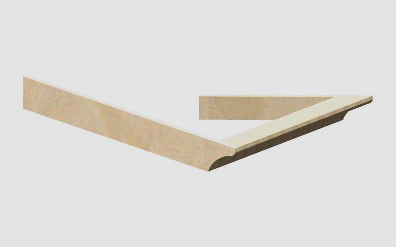

There may be a simpler way, but here is what I had to do to get this to work.
First, draw a line parallel to your roof/cornice slope.(4:12 slope or whatever)
After you have the line profile shape of your cornice drawn, use the profile tool, draw/create the object using the same slope as the line you have previously drawn. (Using the parallel tool helps).
You now have a cornice at the correct roof angle, but the ends will be messed up as they will not be cut correctly. To fix this, I use the SEO tool and simply subtract a straight vertical slab from each end, thus creating a 45° angle at the end of the cornice.
Depending on how complicated the cornice, you may also use the SEO intersection tool.
I have attached an image to show what I am referring to. The front is a sloped cornice attached to a horizontal cornice.
Grant
Grant
