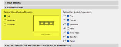

Also, check the Railing setting in the Model View Options Dialog.
Your Railing may be set to "Schematic" display mode in 3D and Sections/Elevations.

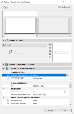

I'm setting up our new template in V27 (old one was V24) and am having a similar problem with the exception that I can see the toprail in plan and section view, but nothing else. I've checked all the model view options, reno status/filters, layers, pens, etc and everything is exactly the same as in our old V24 template.
The renovation status of all the individual railing elements appears to be correct, however I am not able to change the renovation status as it's greyed out when in the railing edit mode. All other railing elements have the same renovation properties.
The interesting quirk is that when I change the renovation filter (which is currently set to show only new construction) to either override or show the existing construction (which we don't use, everything is modeled as new), then the posts, panels, rails etc display in plan view but still not in section.
I can't figure this out...

Check Your Model View Options to see if the railing is set to show as 'Full', 'Simplified' or 'Schematic'.
The MVO was set to full and all of the railing plan symbol components were turned on.
