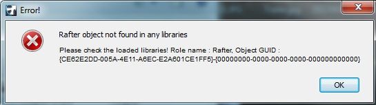

I am trying to use the roof maker wizard with ArchiCAD 13 on a training exercise.
It keeps saying "Rafter object not found in any libraries"
Is this a bug? How can I work around it?

Michael:
In the US version, the RoofMaker Library 13 is in the Object Library 13.lcf library, so check to see if the Object Library 13 (which is in the ArchiCAD Library 13 folder in the ArchiCAD 13 folder) is one of your loaded libraries. RoofMaker needs these objects to work.

I think I have tried loading the 13 libary again, (see attached image), but this time it said default material does not exist.
Can't see any roof rafters yet.
Not sure what to do.
Michael
just tried the tool again & it seems to have worked.
Thanks,
Michael
