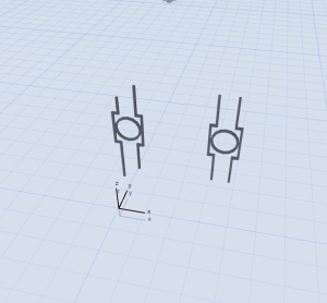

Draw the two following  shapes from Morph – Surface, and then extrude them in 3D by 15 mm.
These shapes will be our Custom Panels. Make sure you rotate your shapes according to the following screen shot to the coordinate system to assure they will form the Custom Panels the way we want.
wp-content_uploads_2017_09_Screen-Shot-2017-09-01-at-08.59.46-e1504261512164-300x278.png
Select one of the shapes (the asymmetrical one), go to File – Libraries and Objects – Save Selection as… – Railing Panel…, then click OK. Repeat with the other shape (the symmetrical one).
After creating new custom panels, go to the Railing Settings dialogue, and set the following options seen in the video below. Make sure you select the asymmetric Custom Panel you created as the panel of your Railing.
