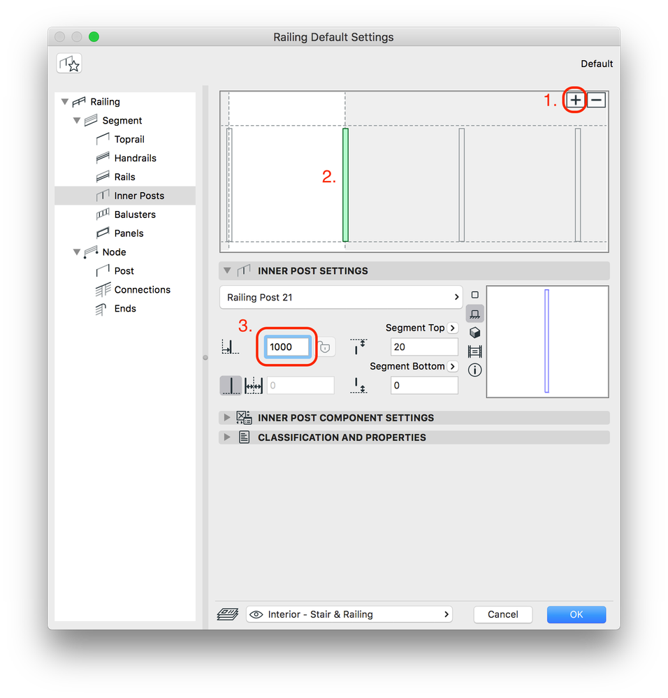

  • Select the Inner Post option on the left and add one to the Pattern by clicking on the 'plus' icon. By placing the Inner Post we define the length of the Pattern. After adding the Inner Post graphically, enter the 'Distance from Previous' value. Let's change it to 1000 mm.

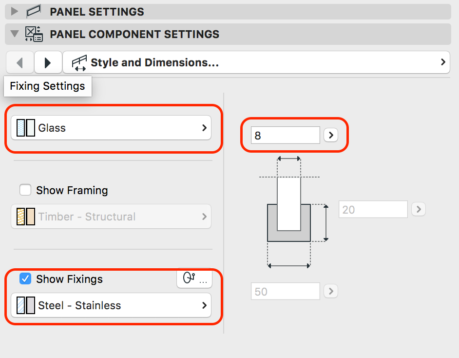

  • Select the Panel option on the left side and add one to the Pattern the same way as the Inner Post was added.

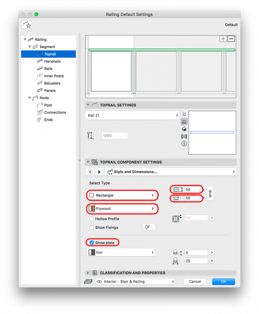

  • Instead of a Handrail, a we will only use a Toprail.
  • Navigate to the 'Toprail' option on the left side, click on the 'plus' icon on the right and add the Toprail to the Pattern.

  • Change the following settings for the Toprail in the Railing Default Settings.

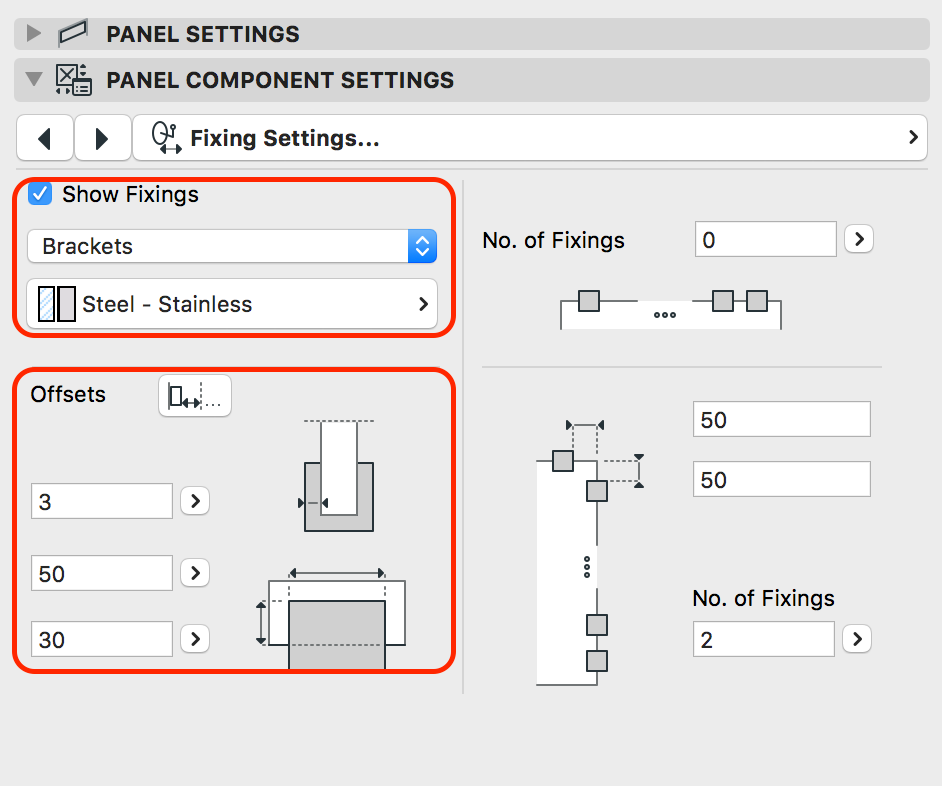

  • Change the following settings for the Panel in the Railing Default Settings.
  • Navigate to the 'Inner Post' option on the left side and set the following values:
  • Navigate to the 'Post' option on the left side and enter the same values.

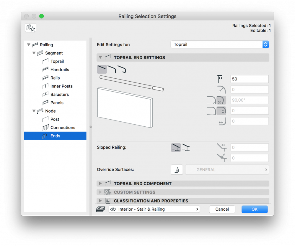

Ends
  • Each type of Rail (Toprail, Handrails, regular Rails) can have a specific ending. It is possible to define the geometry and the length ('Extension Length') of  a Rail. If you do not want to display an ending, set the Extension Length to 0, or use the Invisible Ending component.
  • In this case use the following settings:
