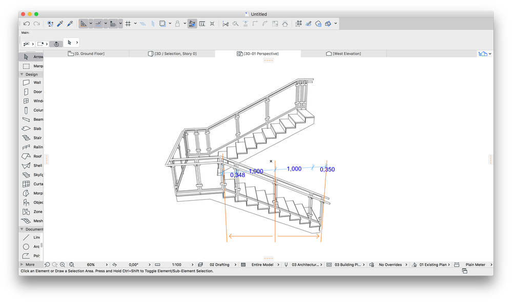

In the Railing Tool settings a Pattern can be defined. Toprail, Handrail, Rails, Inner Posts, Balusters, Panels can be added to the Pattern, which can be repeated within the Railing Segment. This article describes the distribution logic of the Pattern.
Terms
  • The Pattern distribution related settings can be found under Segment/Segment Pattern Settings.
  • Use these controls to define how to distribute the Pattern within the Railing Segment.

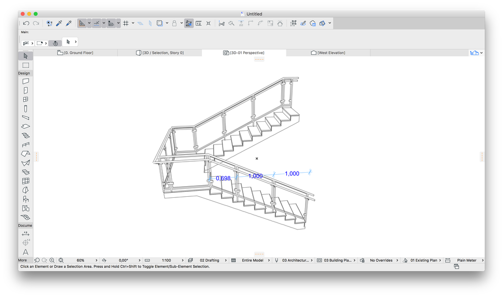

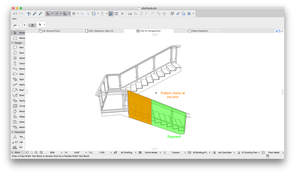

  • Segment is the part of the Railing between two Nodes.
  • Posts are located at each Node.
SEGMENT, POSTS AND NODES IN EDIT MODE RAILING
  • A Segment has its own settings, which include the Railing Pattern and Segment Height.
  • Pattern distribution related settings affect the pattern within a Segment. The Pattern stops at Nodes and starts again in the next Segment. (To continue the pattern over multiple Segments the Pattern Continuity setting (at Node Settings) should be used.

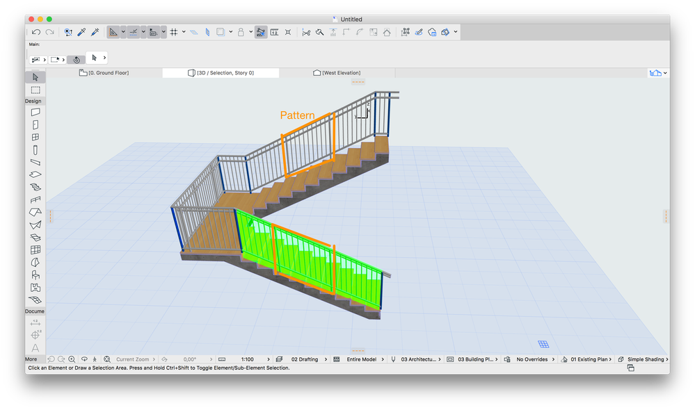

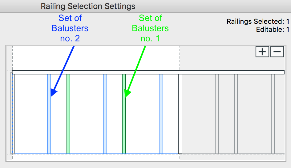

  • Balusters are a pattern within the pattern. You can add more than one set of Balusters to the Pattern. Selecting one Baluster selects all the Balusters belong to that set. Balusters have their own 'Pattern Distribution and Position' settings as well. ('Segment Pattern Distribution and Position' settings have an effect as well.)

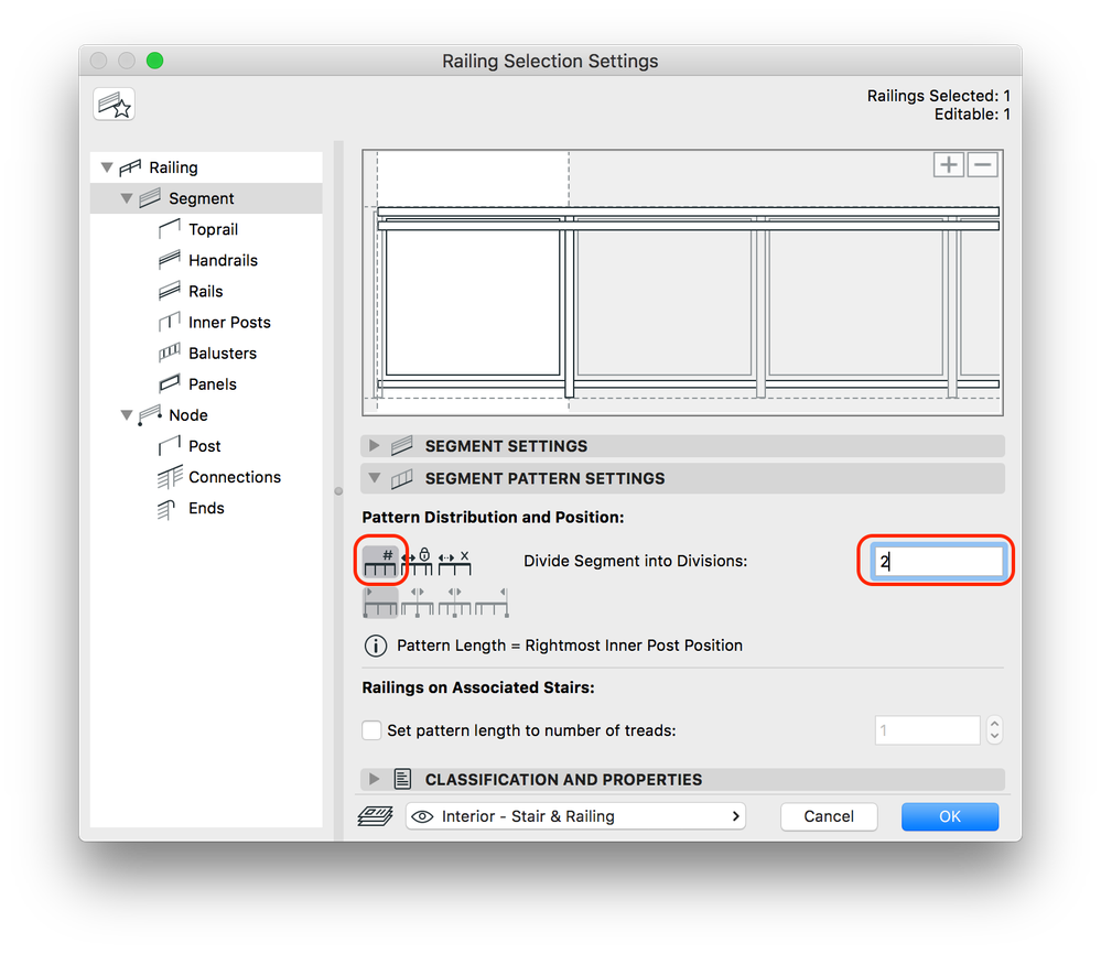

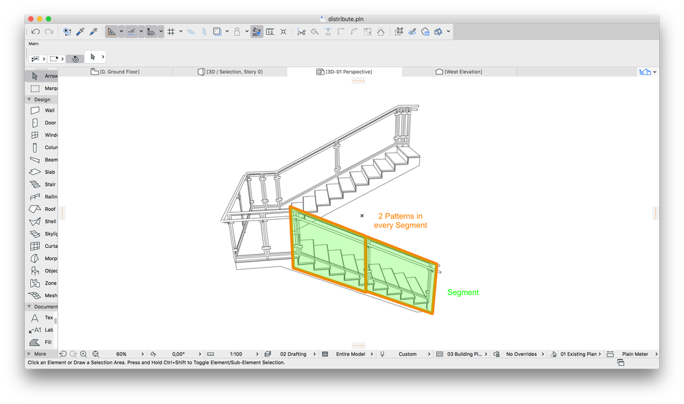

Divide Segment into Divisions
You can define how many Patterns' should be placed in one Segment. In this example one Segment consists of 2 divisions (Patterns).

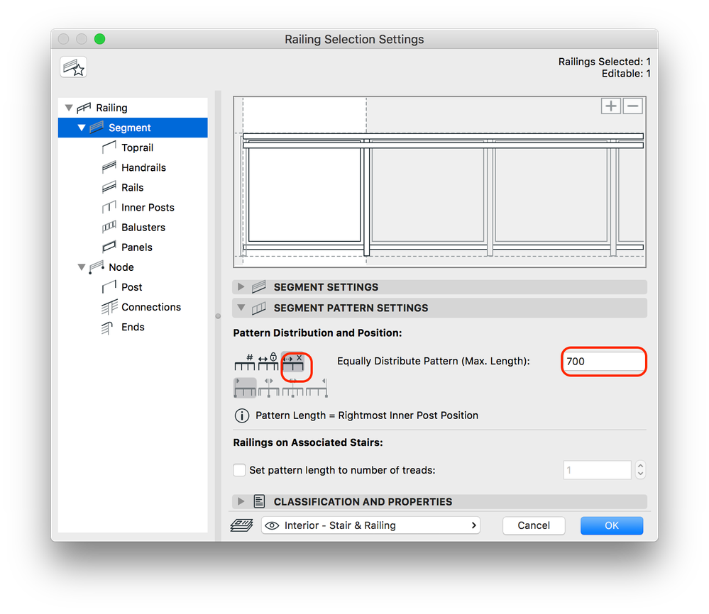

Equally Distribute Pattern

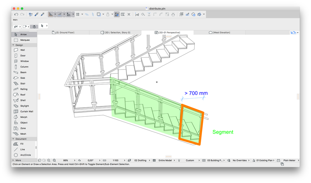

You can define the maximum length of a Pattern. Based on that parameter the algorithm equally distributes the pattern along the Segment. The Pattern is not cut off at the end of the Segment, it is stretched.

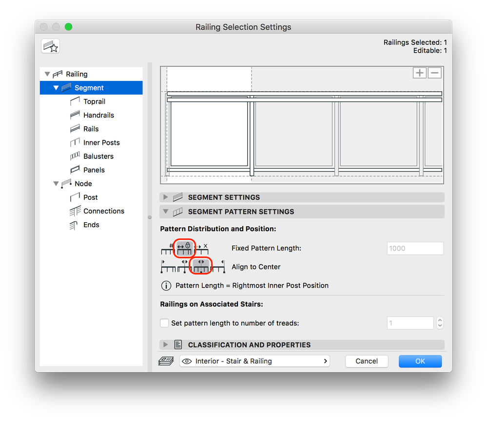

Fixed Pattern Length - Align To Center
Pattern is placed in the middle of a Segment and the distribution is started from the Pattern in the middle, in both directions. The pattern will be cut off at the end of the Segment or it will be slightly stretched if the rest of the length is not enough to create a new Panel or Baluster.

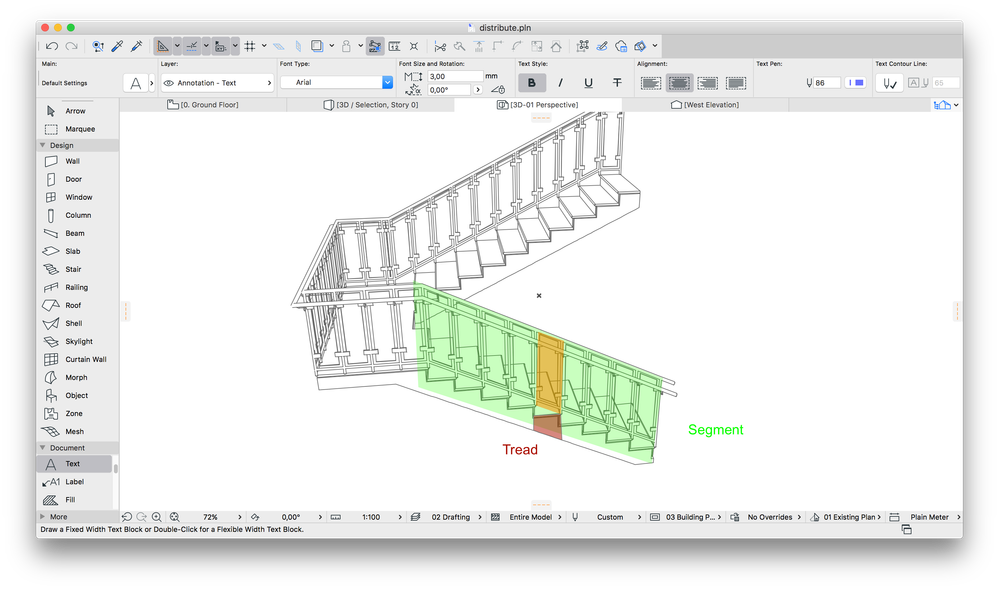

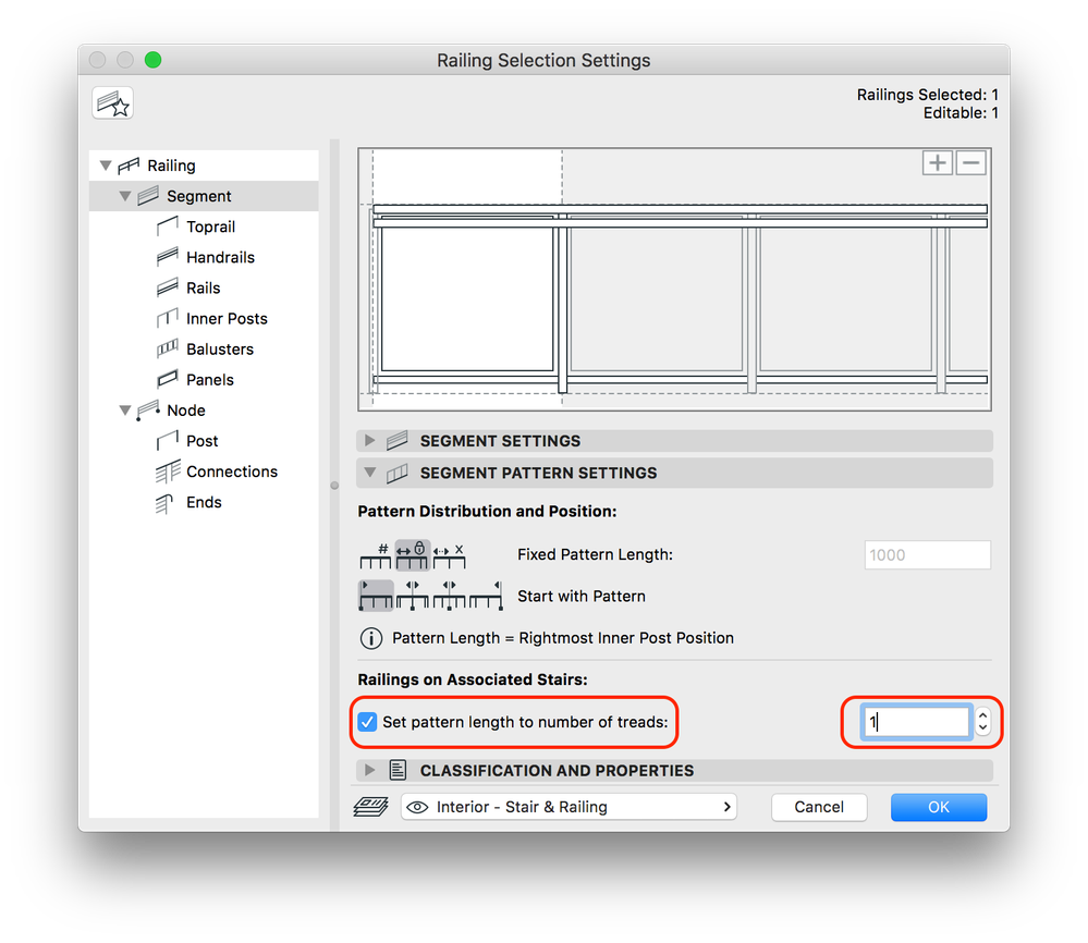

Set Pattern Length to number of treads
Pattern is distributed based the number of Treads are defined in this dialog. It works with associated Stairs only. Position related settings ('Start with Pattern, 'Align to Center' etc.) affect.
