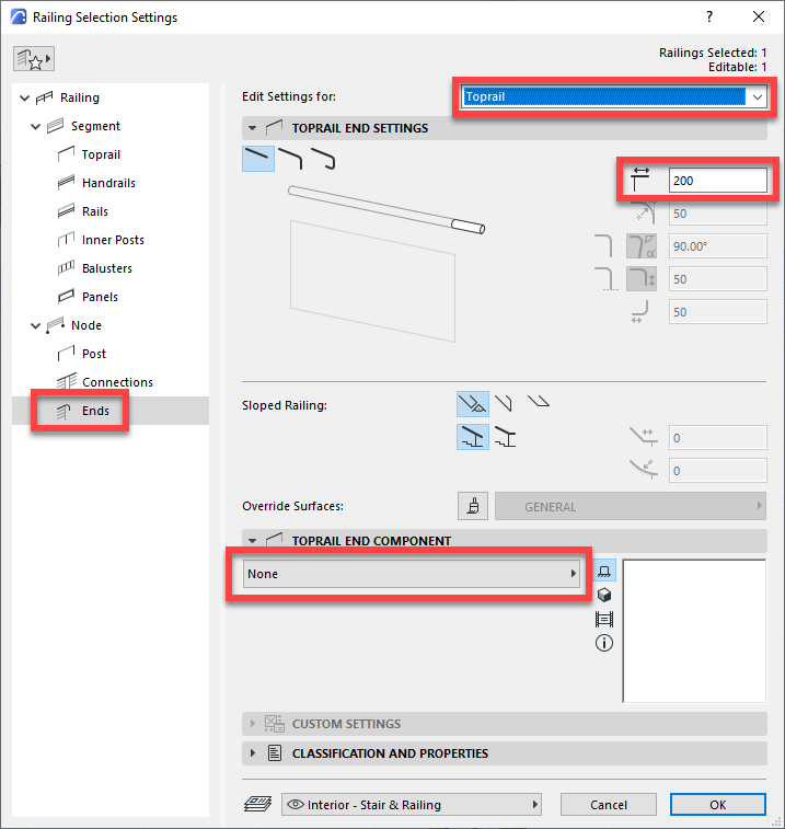

I'm trying to create a custom railing and cant get rid of the end extensions and end cap, what am I doing wrong here?Screen Shot 2021-09-19 at 11.34.06 am.png

A screenshot to illustrate David's point.
Make sure to do the change for all Railings in the "Edit Settings for" field, such as Toprail, Handrail 1, etc.
The "Extension" filed shows "200" now, it should be set to zero.

In the Railing Settings, go to Node > Ends, then at the top left select Edit settings for: Handrail 1. You can then change the end length of the handrail, and change the Handrail End Component to None.
