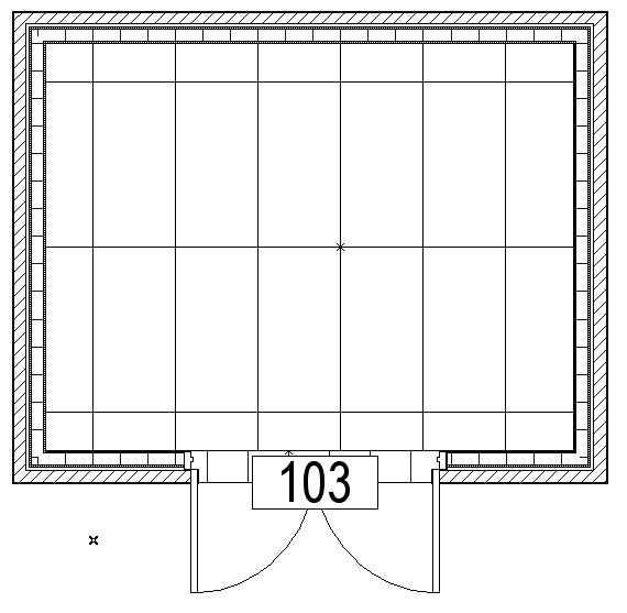

I was thinking I would adjust the color of the ghost story to black as shown in the image below. It would solve the problem of creating the special wall type. I cannot wait until we are able to have walls the cross over multiple stories.
Aussie John
unfortunately the ghost storey image wont transfer to plotmaker
This is one more reason why layers work best. Coupled with good Display Options, all that you need is a saved view set.
