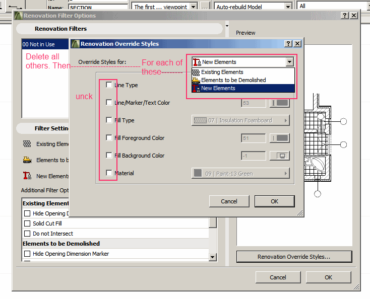

I know lots of folks must like the Renovation Filter, but I do not,
even though I'm only doing renovations.
I like my way of having a separate pln and don't want to change it.
So I've tried to turn off what I consider an annoying "feature" and can't seem to find the option to kill it.
I've of course tried Document>Reno. Filter Opt. and tried to delete all Reno filters but looks like at least one stays active.
Tried to turn it off under: Window>Pallets>Reno.Filter, NO dice even though most if not all other things listed there can be turned off.
Tried AC Help, but once again, no help there that I could find.
So, am I missing the obvious?

Select each view in your View Map, open its settings and change Renovation Filter to "Not in Use" or whatever your equivalent is with no overrides. Shouldn't take more than a couple of minutes (depends on the number of views you have, of course), and will save you hours of strife.

Thanks Stuart for heading me in the right direction.
First deleted all but one, changed it's name, set each of override styles to no overrides by un checking all. Image attached.
So far it seems like that way when I create a new view, it picks up on "Not in Use". So if that sticks, problem solved.
UPDATE: Seems,(so far) that you don't have delete all other RenoFilters as long as last one picked (in my case none) shows up as default when creating a new view.
Still think documentation should have showed up in my searches and G.S. could have made it simpler to just turn it off.
