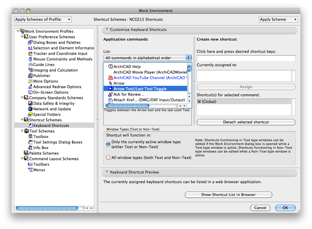

There is the Toggle shortcut. It is "W" by default in the standard environment, but can be customized. It is used to toggle between the arrow tool and the last tool used. So in the case of the line tool, as in your example, you can draw a line, hit escape and then hit W to re-activate the line tool. I have attached a screenshot of the shortcut listing in the screenshot below.
Best regards!

Thanks guys. Will try them all.....looks like the "W" toggle is the one I was looking for.
