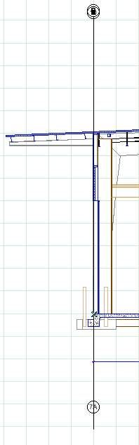

I just "upgraded?" to the latest build (1187) yesterday with library and goodies.Now in an ongoing project with about 20 sheets all set up the grid tool fails to display properly in all sections and elevations. All the markers in a building section appear stacked on top of each other in one location. In wall sections they may or may not show up at all. All the formatting of the markers has changed back to default. I tried placing a new grid in plan with the same results
Has anybody else seen this?
Any tips on how to un-upgrade easily?

Dave wrote:
Please tell me it ain't so.
I just "upgraded?" to the latest build (1187) yesterday with library and goodies. The grid tool fails to display properly in all sections and elevations. All the markers in a building section appear stacked on top of each other in one location.
Dave
Dave,
This seems to be a bug in the 1187 version of the Grid Tool Goodie. We have replaced this with version 1183 on our goodies webpage. Please visit the page and install the 1183 version from there. You do not need to (and we do not recommend to) roll back ArchiCAD to build 1183. Just replace the Add-On.
Thanks for your post - you probably saved others from hitting the same problem.
But alas not me! I backgraded to 1183. But this time I kept a complete copy of the upgraded folder so that change out will be easy enough.
