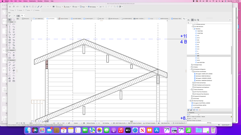

I'm putting in roof composites. Sometimes the whole composite shows up, sometimes parts are missing. It gets to be really annoying. Then, a few minutes later, the whole composite shows up
2026-02-26 03:12 AM
Can you post one or more screenshots that show the exact problem?
2026-03-02 10:19 PM
There is 1 3/8 Wood at the bottom of the composite but it's not showing up. This is a recurring problem.
2026-03-03 01:23 AM
Your Partial Structure Display is set to "Without Finishes", So it is not showing that 'finish' skin of Wood.
2026-03-04 12:07 AM
And the Partial Structure Display setting is stored in Views.
This is the reason why you may see the finish skin, but if you then activate a View with the "Without Finishes" Partial Structure Display setting, the finish skin will disappear again. The solution is to redefine your Views with the desired Partial Structure Display settings.
