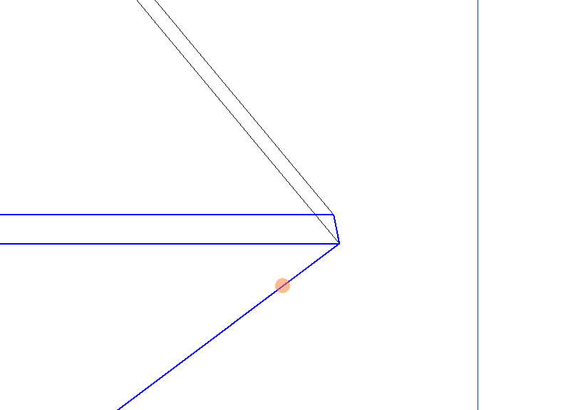

This also shows up on the ends (eaves and rakes). Sure, I can manually adjust the edge to be vertical to make that line go away, but, #1- I don't want to have to do that for every edge, and every time I change a roof plane. and #2 - Archicad has been doing a fine job of controlling the edges with what I consider the proper edge viewing in plan view until just today.
Since this just showed up this morning, it makes me think this is an 'On-Screen' setting that I accidentally changed somehow, but can't I find anything. I'm not aware of any other changes to my system. The roof plan is set to 'Outlines Only', but I've tried the other settings and it won't stop doing this.
I have attached an image showing what's happening. The horizontal blue lines are a roof plane. The difference between the two parallel blue lines is the 'custom edge' (that I did not set) that is now showing on plan. You can see the 2 black parallel lines are doing the same thing for another roof plane.
Anyone have any ideas?

So I've been working on my template, trying to get it updated and work better and it may have been this. When I open up a copy of an older template, the roof lines display properly. This makes me thing even more it is an on-screen view option that my have been flipped errantly.
When I copy the same 'wrong' roof lined planes from my updated template back into my older template, the extra lines go away.
So - where is the setting that I don't know about and didn't know I switched?

Options menu > Project Preferences > Legacy...
If you are using single roof planes and getting the true 3D top view then you will see the top and bottom surface edges of the roof if the bottom surface is larger than the top (i.e. edge not vertical).
Multi-plane roofs you never will because all planes join together automatically.

Thank you! Yes, I switched off the legacy intersections so that I could generate my sections easier, and somewhere read that I should deselect the 'Symbolic Display' option as well. So I did.
For my purposes, for now, I'll re-check that box and now it's looking right again.
Thank you. I'll look into those multiplane roofs later.
