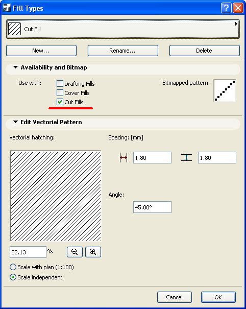

Have you discovered that you can make a composite from what-ever fill patterns you wish? Once you do this you can apply your composite construction to a wall, a slab or a roof. There are no rules here, you are free to create what-ever you need.
For instance in the case of a flat roof (using the slab tool), it makes sense to create a composite of the sheathing, deck, insulation etc. just as it does with a wall or a slab. In the case of pitched, tiled roof construction though, I prefer to model the components separately (unless it's just for scheme design) - this results in accurate sections.
Strictly speaking, composites can only use fills that belong to the Cut Fills category.
Agreed. That's also what I meant about not being perfect. Usually the structure outside the wall is different to the structure inside the wall. Add to that the fascia/soffit system and composites start to fall down rather quickly.
