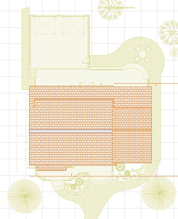

I want to show a roof plan on my drawings. As you can see from the attached image, the roof is 'truncated' I think by the FPCP. The setting for the roof display are "projected with overhead", and display "entire element". Does anyone know why this is the case? I have had this problem for a long time. Your help is appreciated.

If you need the FPCP, raise the cut so it is above the roof (this is set for each View), or just change the Floor Plan Display to Outlines Only (which ignores the FPCP).

Thanks for that. I didn't know FCFP was set for each view. I'll try that out. Much appreciated!
