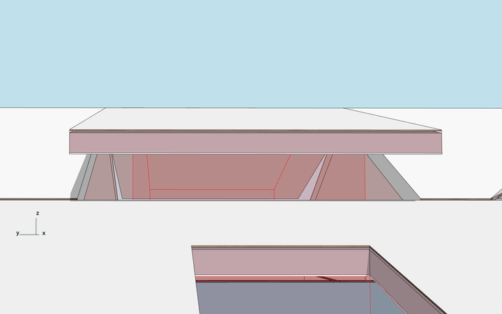

I have two multi-plane roofs.  The upper roof trimming bodies are set to pivot lines. However, when I do the SEO subtract w/ downward extrusion it cuts the roof below at the contour lines.  I can't seem to get it to behave as advertised.  The screenshot included shows the Trimming body and you can see the hole in the roof below is way to big.  Thanks for any insight. Sorry in advance if this topic has been covered, I didn't find it.

SEO does not use the trimming body.
It uses the entire element.
Only the right mouse click Connect > Trim options se the trimming bodies.

For some reason thought I could punch a hole in the roof below using the pivot lines of the roof above. I'll use a different method.

Solution
Thanks
You can if you right mouse click > Connect > Trim Elements to Roof/Shell.

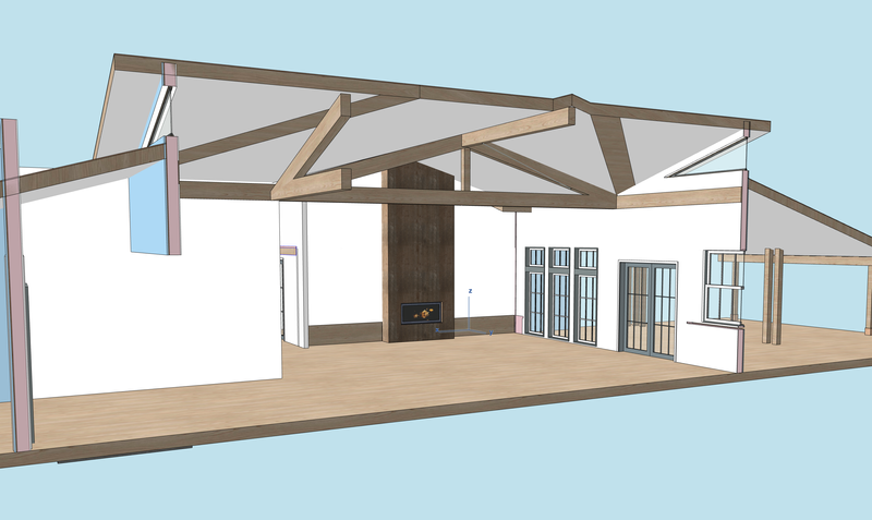

By the way thanks for the help on this.  So when I use trim to roof, the intersection point of the two roofs is the color of the cut fill.  See attached.
I'm not sure what is going on.  Basically have two cross gable roofs intersecting. Why is this so difficult?
