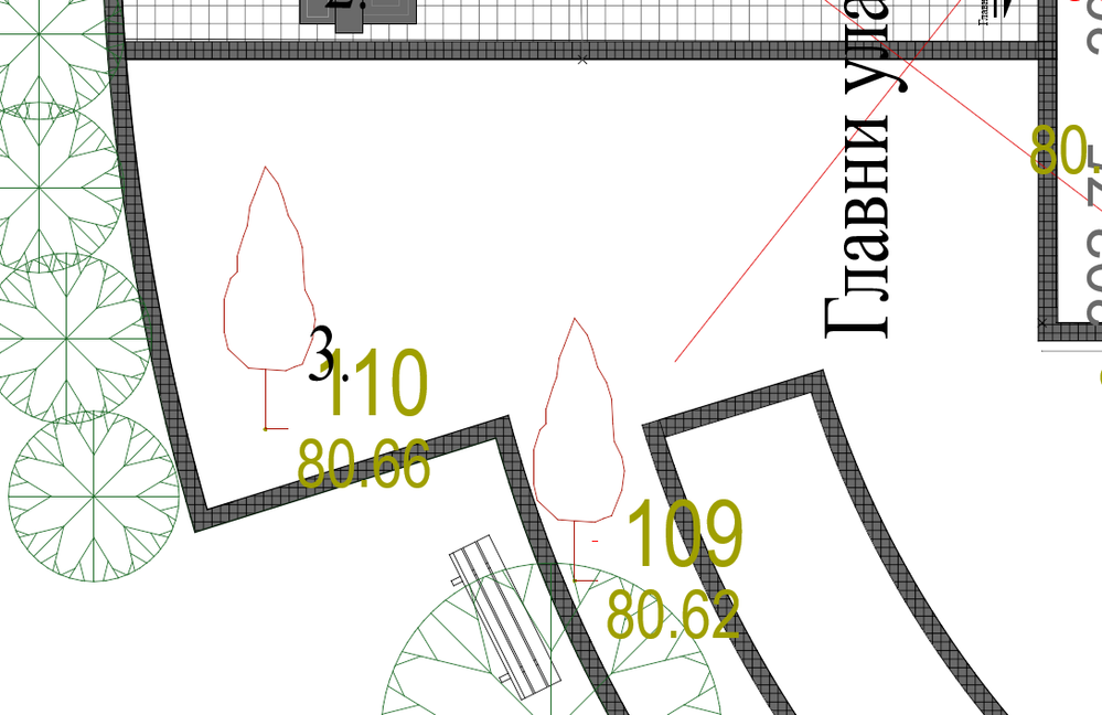

I need to create a radial paving pattern with concrete pavers in Archicad. How can I achieve this?
Teodora994
I am working for a company that specializes in patterned landscaping and paving. I need to create a radial paving pattern with concrete pavers in Archicad. How can I achieve this? I have tried using radial fill, it only make the fill strech. I used the radial fill in Archicad, but it only stretched the fill, and the dimensions of the concrete paver blocks were not uniform. This is the image where I have to put the fill.
Operating system used: Windows 10 !

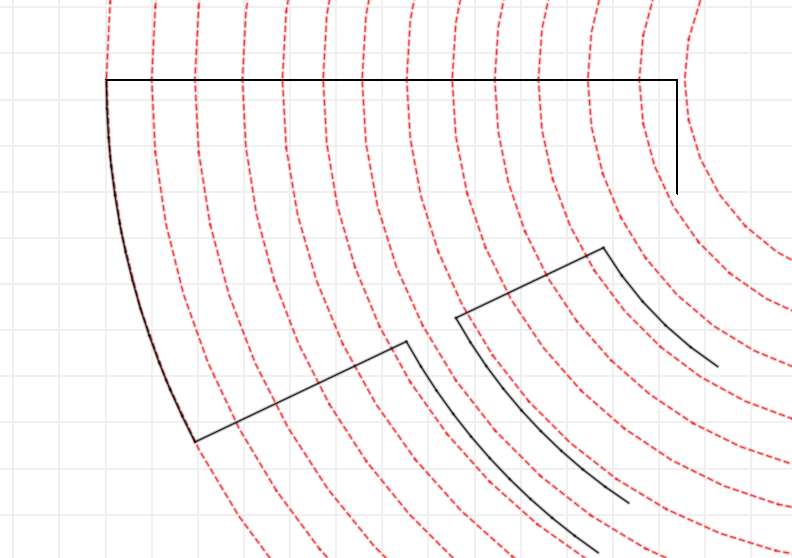

I don't think you will be able to get that in one fill, with you wanting to keep a consistent paver size.
You can do this using several fills, if you really want to hold on top the idea of using fills, otherwise is all line-work as far as I see it.
Even with the multiple fills, you will still have a distortion of the "paver size".
That being said, here is a solution for the multiple fill in short steps:
1 - Make the fill and save it as a cut fill.
2 - Make a material and apply that fill as "fit to skin"
3 - Make a composite that uses the material in the true width of your pavers
4 - Make walls that use that composite parallel to each other in the progression that you would want to see the pavers
5 - Cut all walls from the model space and past them into a worksheet.
6 - Delete all skin separators and other lines and keep only the fills of interest
7 - Modify "row by row" fill with the radial distort as needed for your application. This is never fun...
8 - Enjoy your fill collection.
I would stick with the 2D and array option...
Good luck!
