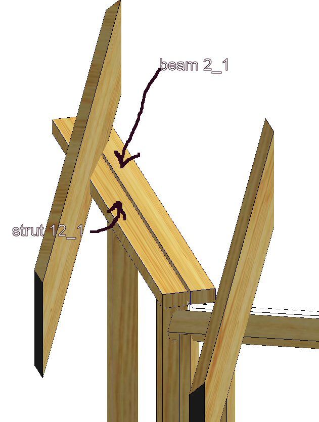

Is there a library part I can use for a plate that needs to pitch in two directions?

Steve Jepson
Peter wrote:
If you want just the top plate use the roofmaker object strut 12_1.
rotated about the Z axis to any angle and then calculate the pitch angle and enter it in the object settings.
It is the 12_1. strut, and I do just want the top plate.
It is not hard to model but I need it to be show up correctly in my materials list.
The roof is 10:12 (39.81 deg). slope of the strut (plate) along the wall is 30.51 deg. How do I rotate about the other axis? Do I need to switch thickness for width and stretch it the other way?
I tried all of the roof framing objects and none of them let you change more thatn one pitch variable. I think it will take a new line in the GDL script. I don't know how to do that very well. I was able (with Laszlonagy help) to add the script that will show the actual lenght on the slope to all of my roof parts. It works great! I am sure it would be just as easy to add an aditional pitch variable. If someone knows how, please let me know.

Steve Jepson
I think beam2-1 will do the job Peter. I am still playing with the settings.

Steve Jepson
Actually, I dont think the beam will work either. The settings are way to squirly. Change the rataions angel and the pitch changes, chage the purlin rotation and lenght needs to change. It turns out to be a game of chase your tail around and around. I was never able to get the beam to work. Try it yourself and see. It has the settings for a potential solution but to acheive it may not be possible. Trial and error is not a method likley to work for this. Look again at the original picture. The plate that is shown is correct except for the slope it also needs to match the bottom of the rafters.

Steve,
I tried making the plate using roofmaker's "Beam 2_1.
It seemed to be working until I made the role angle non-zero.
I haven't checked yet but it seems as though the role parameter
is not coded correctly in the script. My guess is the rotation in the
script is about an axis laying in the X,Y plane rather than about
the major axis of the object.
I will look into it.
