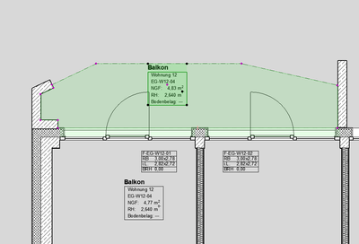

Hello all,
I attached an image showing how the room area overlapping with a portion of the wall near the window opening. this porion is created by the window settings (I don't know what is called in English).
but I looked in window setting I got nothing.
Thanks and best regards

If by 'room area' you mean 'zone', then have a look at the Project Preferences > Zone settings.
Thanks for the Reply Barry,
I have this panel already set and it should be (almost as you presented), however there's still some overlap happening on outerside of the window at the side edges.
 it should take the window area into count, but not where the insulation is covring the window frame.
best.
Hi @Almanla,
I suggest you contact your local Archicad distributor and provide a plan file + steps to reproduce the issue. They will be able to perform a more detailed investigation. You may find their contact here.
