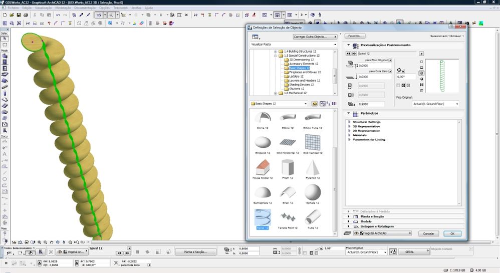

Indeed Objective is a very handy tool for that tuff jobs... No doubt...
But in this situation... a "simple" complex profile ( ) and a SEO´ed "Spiral 12" object could easily do the job too...
Again... Prepare for a nightmare polygon...

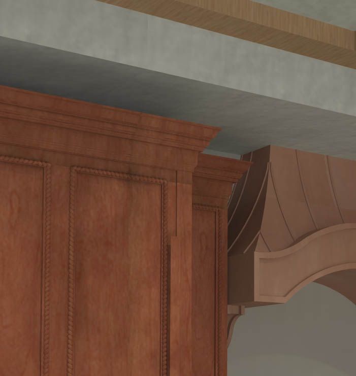

Steve Jepson
Woodz31,
How's that miter work'n for ya? This is made with ArchiCAD only.
Shot at 2009-08-25
Haven't worked the objective moulding into the crown yet but this where I'm at with just useing the ac 11 sprial object set to simple, not bad so far.
Steve Jepson
looks great!
Well done Woods!
Just to check... How is your machine handling this?
