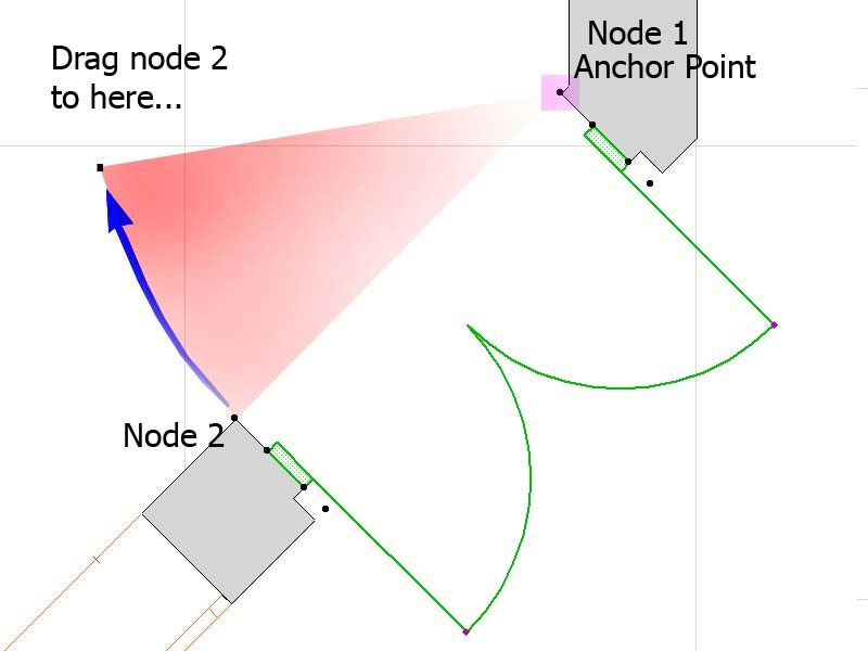

Yesterday I stumbled across, somehow, rotating a door or opening in a thick wall. One point was anchored, and I was able to grab and rotate the opening, to cut through the wall at different angles vs. the normal stock 90 degrees.
Anyone know how to do this a SHORT and EASY way to do the below?
1) Anchor Node 1
2) Move node 2 to arbitrary point to change door/window/opening angle in wall
Clicking any of the nodes on any of the objects I've tried (I've worked through half the international library in the last 2 hours) does nothing except FLIP the window or door opening. I've delved deep in the reveals, but usually there's no options for angles there (despite threads on the subjects-is this a library issue?)...
HOW do we anchor a side and then rotate the opening in a wall (for windows and doors as well if possible)...??? Is it possible to anchor a note on a x,y,z axis and drag the angle by grabbing another node? I don't need to resize the door/window/opening, just angle it at the base, either in 2D or 3D- wherever it is currently (or if it is) possible.

If I'm understanding you... openings are associated to walls -- they will be inserted "parallel" to the wall's reference line, they cannot be rotated. I'm guessing you had an "original wall" in which the door was inserted, and you rotated the wall, not the door. To accomplish what you're (I think) describing, you'll need an "extra wall" for the door. You cannot have a door without a wall.

Sorry mate, but you're only making mistakes. It can't be done and as Laura says, you're rotating the wall, not the door. Next time you rotate it, check the info box, I guarantee it will show the wall tool, not the door tool.

Even if your wall is very, very small, it is still there - put a thin marquee over the door, careful not to touch other walls, activate the wall tool, CTRL A - and the wall will be selected. Now you can edit it ...
Stretch it to the ends of the door, and the door will be free floating in space.

I agree with the others that you must be actually rotating the wall so the door looks like it is rotating.
That's the only way I can get it to work in a normal wall.
How ever if you draw the wall as a polygon wall you can place any door or window and then rotate just the window or door to your heart's content.
The only problem with this is you can't use the composite fills if that is important to you.
But you can use any vectorial or symbold fill pattern.
