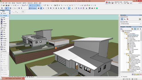

when I drag a copy of my model all the walls that were "subtracted with upward extrusion" at the roof, return to their original height. What's going on?
Dave Brach/architect AC28 Macbook M4 Pro OS Sequoia
4 Replies 4
You need to copy the operators as well as the targets, at the same time. (You can't copy the targets, the copy the operators)
