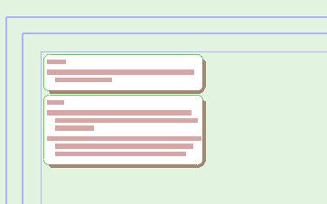

Any fill or line using the same colour pen as the background will be changed on screen so you can see it.
Another option is to use a non-white (or black) background.
I use a pale green like the old manual drawing boards.
