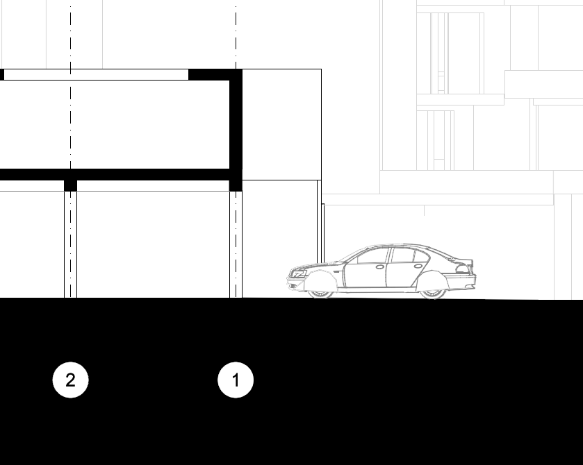

My biggest issue is that I can't find any property that would make objects in sections ''non-cuttable''. Is it really a thing, like Archicad really doesn't have that option ?!

If it’s a 3D modelled element, it’s layer is on, and it’s renovation status is visible it will be cut by a section or elevation.
if you don’t want it cut turn off the layer in the section settings.

Why would you not want to cut something if it passes trough the section line?
If you are talking about the mesh or slab at the bottom of your image, move it so it is not cut by the section line.
If that is not possible, hide the layer in that section view.
Or place a fill over it to disguise it.

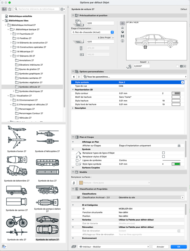

Hi Villach,
You have two options : Modify the cut line to not cut the objet,
create a 2D object or place an existing one in the section and mask the layer of the 3D one.

So this is really a problem because we need to duouble our time masking the cut elements or replacing them with 2D. Existance of ''on/off'' button in objects properties would make this a lot easier. Right now I don't have a problem because I can break section around car, but if it was through buildings object then it would be big problem!
Well I hope they implement exact feature in Archicads new version, if its not there yet (I am using 25)
You mis interpreted my comment about this ‘feature’ in Revit not Archicad, in Revit some classes of family are not cut in section no matter whether they are 3D or just 2D.
i would not typically show 3D entourage elements in sections these elements would just be for 3D views so I have a layer called entourage_3D that is only visible in 3D presentation layer states.

No it's not a double time work. Masking those 3D element is just placing them on a specific layer that you turn invisible for section's layers combinations.
Layers combinations are stored in vue so you'll have to do this only once. This can be set in your Model.
Place a 2D object is just one clic.
