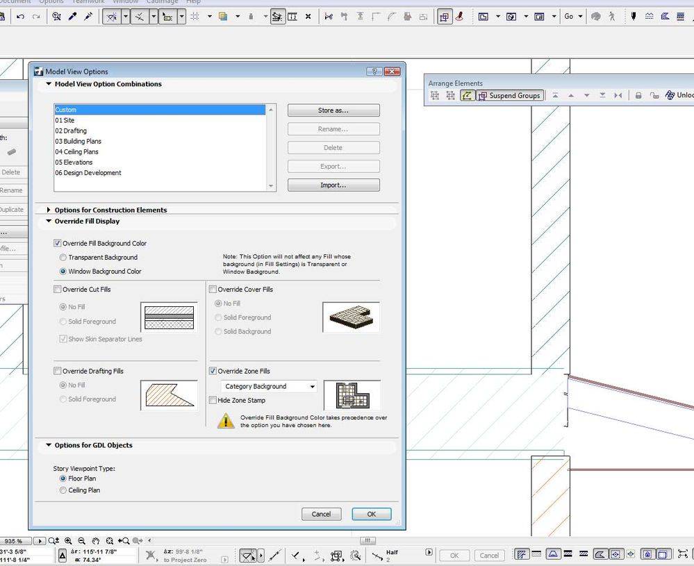

I can't get the skin separator lines to display in my sections. What am I doing wrong?
The attached image explains it best, I think.

In general, Check over-ride fills and then you will have this option available.
I am not sure which wall you are unhappy with.

None of the separator lines are showing, so it's all of them that I'm unhappy with. I've tried every variation on Model View Options with no luck.

Lindsay, you need to have a different name for the finish skin to show the separator line.
If the finish skin is to be the same fill as the core you will need to have a
different named fill, core fill 1, core fill 2.

Thank you very much! I didn't know that was the case...
