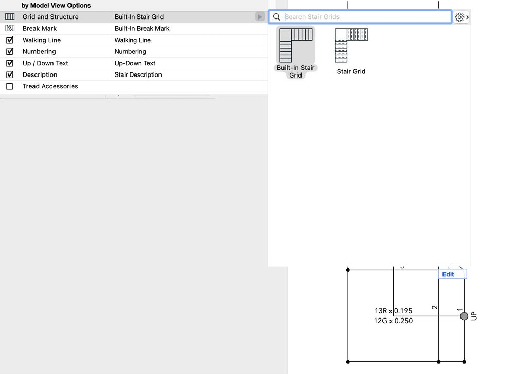

alexliz
I am coming back to this one now that I am using Archicad 29. The selection of multiple treads/risers via the piano-like pop-up is not working again. I am thinking it has to do with how I load my libraries, because when I do a New & Reset All it works.
I noticed that in the Stair's settings dialog I can choose between 'Built-In Stair Grid' and just 'Stair Grid' but, if I do a New & Reset All I only get one stair grid, not multiple ones. Regardless of which one I choose the issue with selecting multiples persists. But I am noticing the two grids. Might that be related? Might it have to do with how I load my libraries?
FWIW I can select multiples, by holding SHIFT and clicking one each one.
