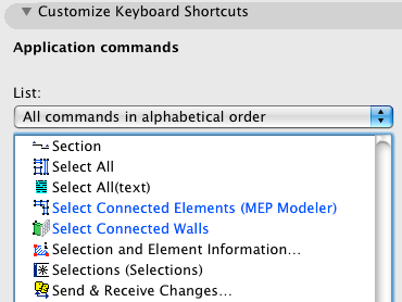

Karl Ottenstein
Djordje wrote:
Why does the right click not work for you? Select and activate tool is the first on top, after the settings.
Djordje is right, of course. Forgot it was there - as Xristina points, out, the command does not appear anywhere else in the interface or in the Help files. Screenshot of available commands attached.
Roberto - I have not looked since AC 10 or so, but there was an undocumented registry/plist setting which made the context menus available for editing. Was no reliable as I recall, and I also do not recall that it permitted shortcut assignment even then, as you say. (To all: undocumented registry/plist settings are use-at-your-own-risk, of course!)
Cheers,
Karl
