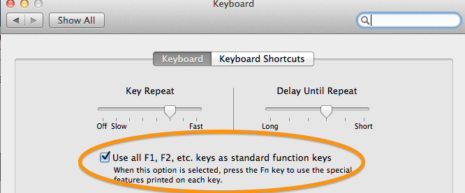

Eduardo Rolon
check the function key setting in system preferences

Llian
YES!...it works! Thanks for the picture.
