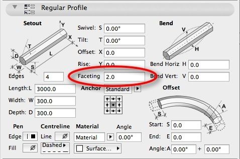

Ralph Wessel
Dave wrote:
I modeled the logs using Objective with a taper to them. I deleted the taper and now the seo's are not slowing things down as much. As far as the special menu goes, never found the command for show intersection of forms
If you're experiencing any slowdown that is possibly linked to curved faces in profiled objects (made with OBJECTiVE), you could try adjusting the smoothness to find an optimum balance between speed and visualisation.
If you look at the custom settings for OBJECTiVE profiles, there is an item labelled 'Faceting' (see image). This is the tolerance for curved faces, i.e. how far the approximation to a curve is allowed to deviate from the true curve. The higher you make this value, the more course the curved faces will appear in 3D (but also, the faster they work with SEOs and other 3D operations). You might find that a higher value will allow you to keep the tapered edges without causing too much of a performance hit with SEOs.
