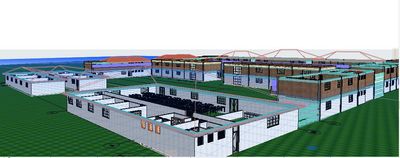

Hey ...I have a problem with my slab roof and objects...they have their fills but have suddenly turned to transparent in 3D
How do I remedy the situation..I've checked all the recommended 3D settings so that isn't the issue

Check the layer(s) hosting those elements, within Layer Settings you can have a layer display as wire frame, along with visible & locked. This setting can change according to which Layer Combination is applied to that view.

THANK YOU SO MUCH! THIS IS EXACTLY WHAT THE ISSUE WAS...I TRULY APPRECIATE

You may want to post a screen shot of the issue for more accurate responses. By your description and your stating you have checked ‘all 3d settings’ (including GOCs?), I’m thinking perhaps some layers were accidentally turned to wireframe?

 This is what it looks like
