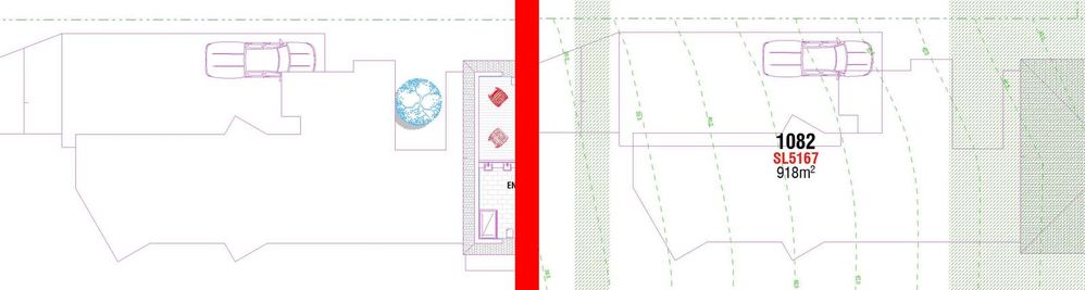

Hi all,
I have an odd situation.
Two slabs that in one storey hide each other, on a storey above they don't anymore
I've attached a couple of images to explain the point.
Fill is set as 100%, works below, doesn't above!?
Any suggestion?
What am I missing?
Thank you!!
C.
Works here. Have you checked Slab Settings > Floor Plan and Section > Show on Stories > Custom? Whether the fill is displayed on other stories can be set here.
David

Perfect David! You are the man!!
