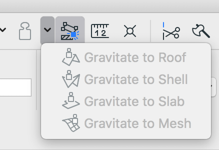

I am working on a single home that has many interior split levels. I want to show on the floor plans the various slab thicknesses and levels relative to the storey levels.
I have used the Level tool but it shows only the slab thickness. I tried the Gravity tool but it is greyed out. Can anyone help me with this?

If you are working in a model plan view (not a worksheet or detail view), and have the Level Dimension tool active (the cross hairs one), the gravity tool should be activated.
Another way is to use the Label tool - it has more flexibility over what to show, including RL and thickness within the one label.
