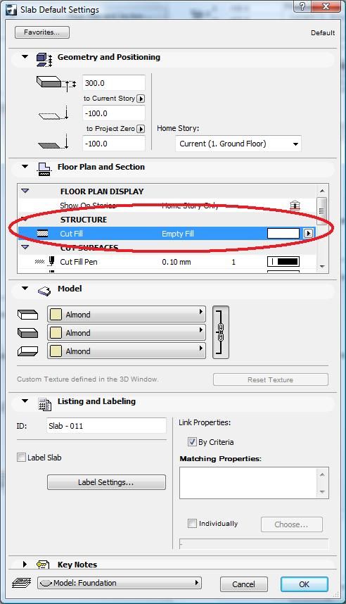

I am new to achicad 10. The option to change the slab thickness is in gray. Is there a way to edit it ?

Looks like you have a composite fill attached to it, if you change it to a vectorial & symbol fill you should be able to then edit the slab thickness.

woah fast reply, thanks guy for my probs solved
