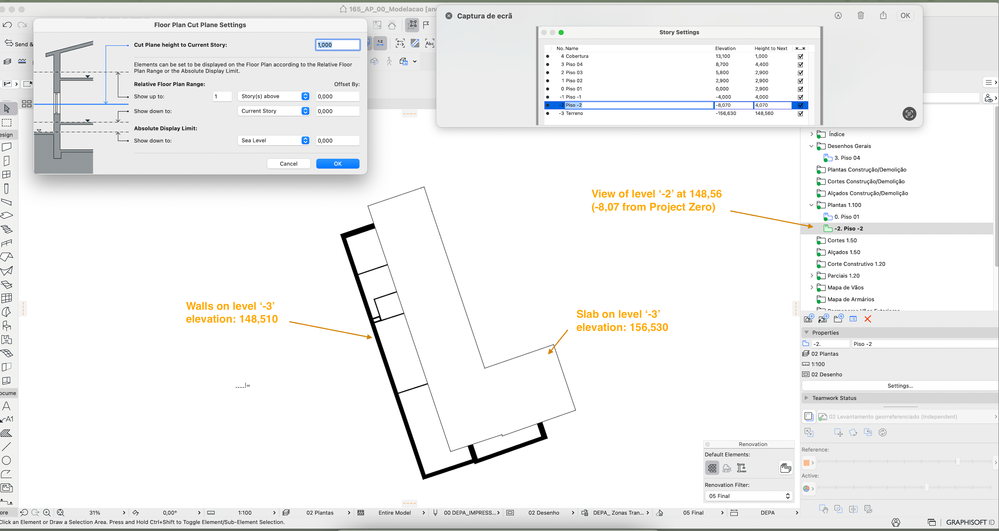

I found a similar problem on another topic but I still wasn't able to fix the issue.
I created a level to build a terrain (-3) and the preexisting building. The different slabs from the preexisting building are referred only to the terrain level with different highs (148,63 / 153,31 / 157,73). I did that because if I want to change the ground level in the future the position of the building will not be affected.
I've created the levels according to the new building: 148,56 (-2) / 152,84 (-1) / 156,63 (0)
When I open the "-2" level I don't want to see the slab of the existing building at 157,73. Yet, even with the 'Floor Cut Plane Settings' I can't hide it
See attached print screen.
Thanks.

Check the floor plan display options for the slab.
Sounds like you want it to display on 'Home Storey Only'?
