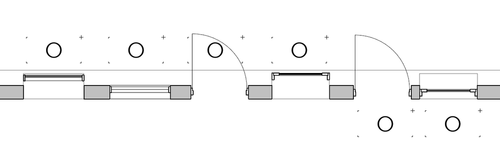

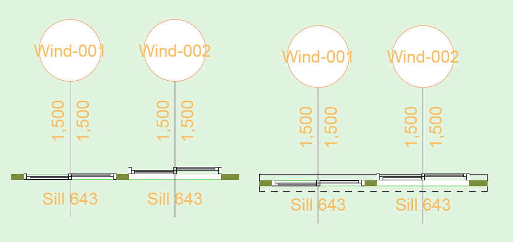

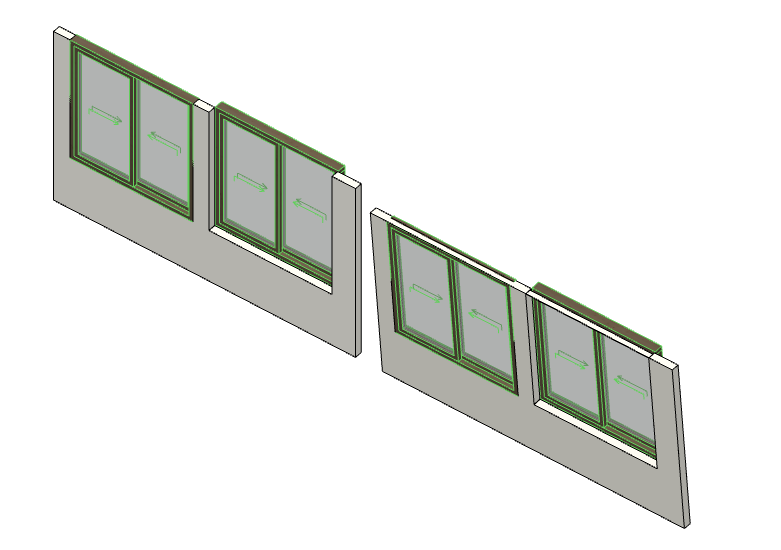

Hi all,
It would seem like reveal depths for vertically aligned doors and windows in slanted walls was never fixed. For some reason I though this had been fixed in 24...
Standard INT libpack door and window:
Ling.
5 Replies 5
What's not working.

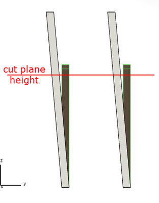

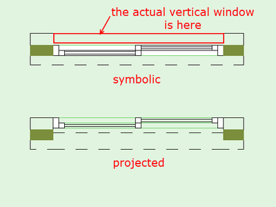

The Symbolic representation of vertical doors and windows does not align with the Projected. Symbolic is offsetting from the cut face, so will vary depending on your FPCP.
Ahh, I get it.
The symbolic (vertical) window is always shown in relation to the cut part of the sloping wall, and not in its true position.
This is not correct as the window is not in that position.
Which is a problem if you want to show the symbolic plan view of a window (which I prefer).
