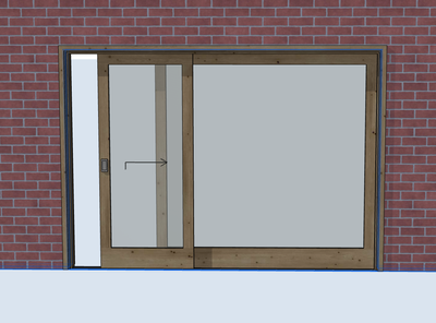

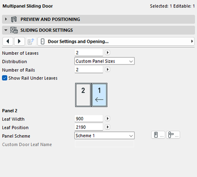

The new Multipanel Sliding Door can do this. It can be found under "Special Doors".
The leafs are all move independantly which can be a bit annoying when you are wanting to show them open in 3D, but closed in elevations and sections....

Thank you Ling. Didn't have the newer library loaded due to an older file setup.
