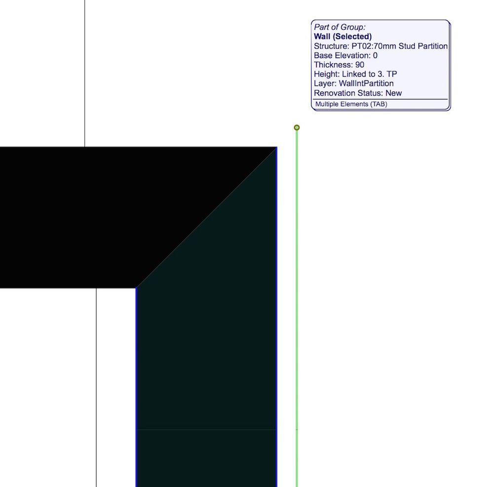

I'm working in a view that I have made to show "without finishes". I was wondering if there is a way to tell the cursor to refrain from snapping to the hidden finishes?

I think you will find it is not the finish that you can still select but the reference line of the wall which is selectable regardless of which partial Structure Display you use.
What you will want to do is set the reference line of your walls to the 'Core Outside/Inside' rather then the 'Inside/Outside Face'.
This would make it easier when modelling also as it is the core surface that you will want to position (and dimension) in your model rather than the finish surface.

The attached image shows you the ref lines on a composite wall and you will see even when you turn of the finish or other skins then the reference line is still in the original location and is still selectable.
