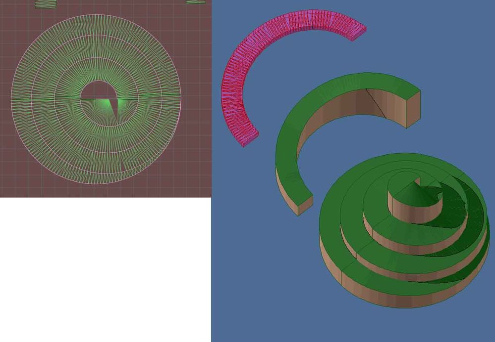

You might find it useful to take a look at OBJECTiVE. This add-on provides additional flexibility for 3D modelling that seems well suited to the shapes you wish to model. For example (referring to the attached image), you could:
  • 1) Draw a cross-section through the spiral roof and use OBJECTiVE's profiling tools to create an object;
    2) Use OBJECTiVE's tools to bend, offset, rotate etc, and/or set the object's parameters directly to suit the overall rise of the spiral, diameter, etc;
    3) The example in 3D
The objects and tools provide a lot of flexibility for both creating and editing your designs.
