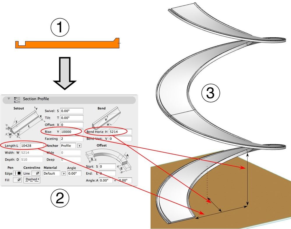

kakapo wrote:You might find it useful to take a look at OBJECTiVE. This add-on provides additional flexibility for 3D modelling that seems well suited to the shapes you wish to model. For example (referring to the attached image), you could:
I need to create a spiral roof. By spiral I mean it should look like a straight slope, just on a arch-like plan. Like a wooden path around a mountain. So that beggining and ending edges are parallel to the ground. Is it possible in archicad?
