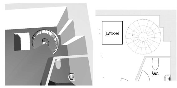

I wonder if I can change the properties of a stair, in this case spiral, to be hidden by a slab.
In 2d I want the slab to hide pieces of a stair that is on the story below and shouldn´t be visible.
I hope you understand my question.

Yes, you could do this!
Use coverfills for your slab, then use "Display order" to place your slab over your stair.
