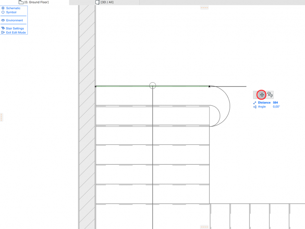

  • Select the second Tread and make it curved.
  • Click on the edge of the selected Tread and select 'Edit segment using tangent' option from the Pet Palette and draw a horizontal line.
  • Click to finish the input.
  • Let's select the first Tread and add an additional node to its longitudinal side.
  • Then extrude the edge between the corner and the new node to the end of the second Tread.
Curve the shorter edge of the Tread the same way as the second Tread was curved.
Adjust the edge of the first step to the right position

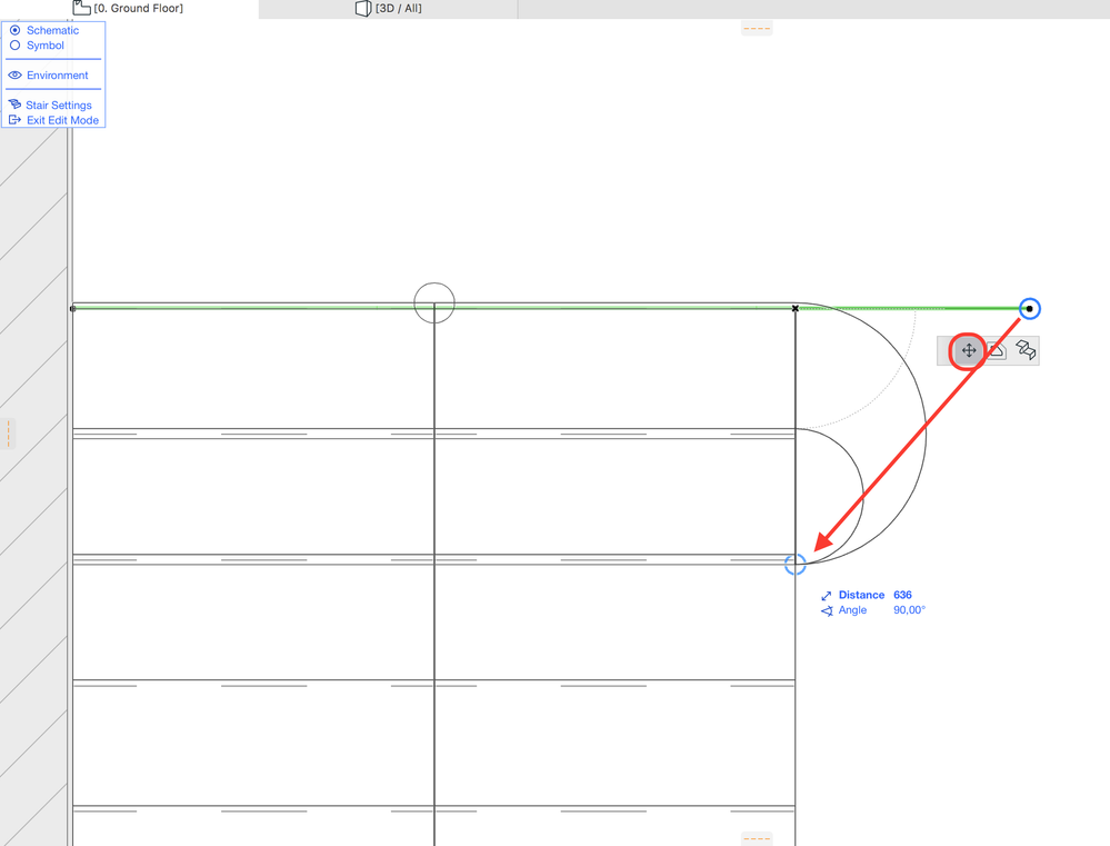

  • The Treads are ready, now the Risers need to be edited.
  • Select the Riser of the first step (dashed line) and stretch it.
  • Add a node to the Riser and move it to the right position.
  • Drag the endpoint of the Riser in order to make it vertical.
  • Curve the Riser using the 'Edit segment using tangent' option from the Pet Palette.
  • The same steps should be made with the Riser of the second Step.
