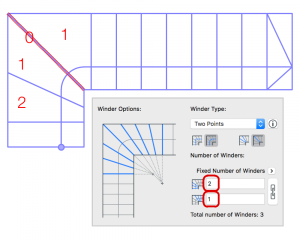

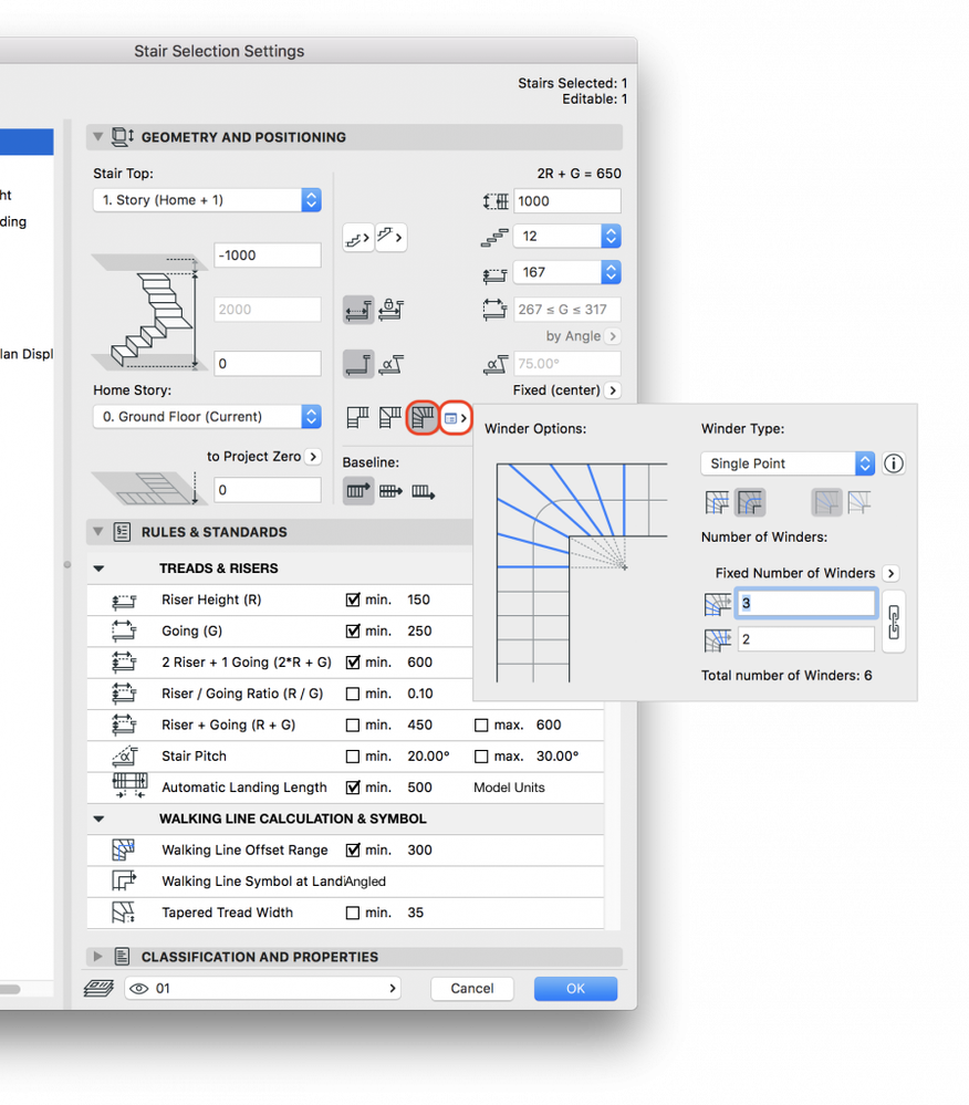

You can open the winder options dialog either from a Drop-down menu in the Stair Selection Settings, or by clicking on the corner (Turning node) of the Stair, and selecting Turning Type Options from the Pet Palette. On the top Winder Options Panel, you can choose one from the 4 winder Types available in ARCHICAD,  choose the shape of the walking line (curved or straight), and also whether there should be a middle step or not (this is not available for all types). On the bottom part, you can set the number of winders. It is preferred to use a Fixed number of winders if you know what kind of shape you are looking for, but you can also enter a minimum number, if you want ARCHICAD to decide. The numbers you can enter in the fields under that will always be counted back from the middle step of the winder (or the middle riser if you choose not to have a middle step). You can see how in the pictures below.

  1. Open the Default stair settings dialog, and set up the story height and your stair rules according to your taste or local standards.
  2. For Turning Type select a 'Winder with Equal Goings' and set up it's settings according to your needs by clicking the Turning Type Options button (next to it).
