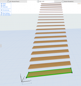

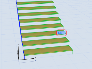

  • Select the Stair and activate the 'Edit Mode' by clicking on 'Edit' appears next to the selected Stair.

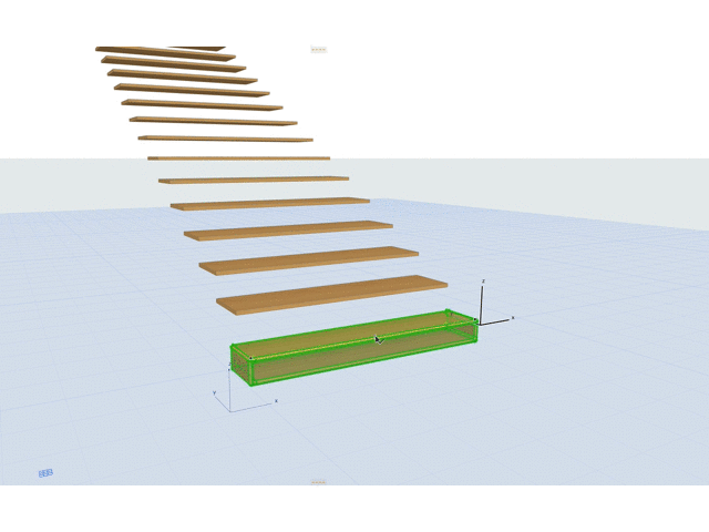

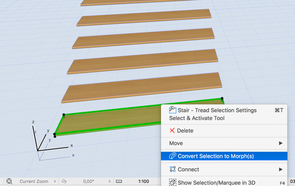

  • Navigate to 3D and select the first step of the Stair.
  • Do a right click and select 'Convert Selection to Morph' from the Contextmenu. A Warning Dialog will pop up, close it by clicking on OK. The color of this element will be changed. This indicates that the first step is a Morph now. (The first step is deleted automatically).
  • Exit the 'Edit Mode' by pressing Esc.

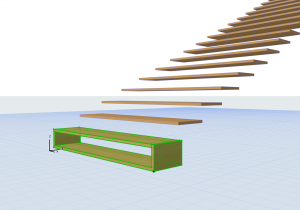

  • Select the Morph and create your custom Tread.

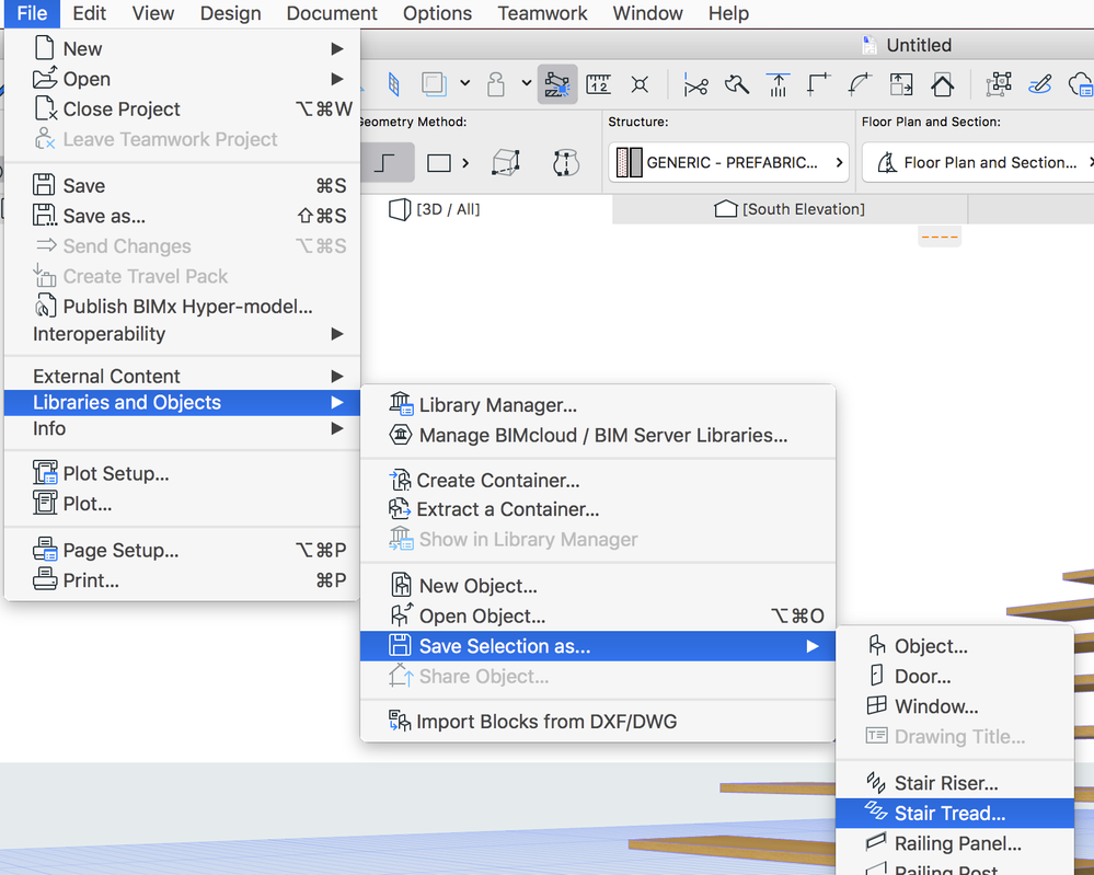

  • Keep the Morph selected and navigate to Files › Libraries and Objects › Save Selection › Stair Tread
  • A Dialog pops up, close it by clicking on OK.
  • The Tread needs to be saved into the Embedded Library (by default),  the 'Save Tread' dialog pops up, where proper name and location should be defined. Click on 'Save'.

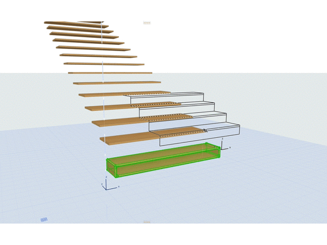

  • A Ghost preview will appear in the 3D window. With this preview you first need to define the position of the Tread. You need to find the middle point.
  • Secondly the orientation is needed to be defined.
  • One other dialog pops up where the basic settings of the new Tread (eg. surface, pen) can be defined. Click ok.
  • After saving the custom Tread delete the Morph or hide it.

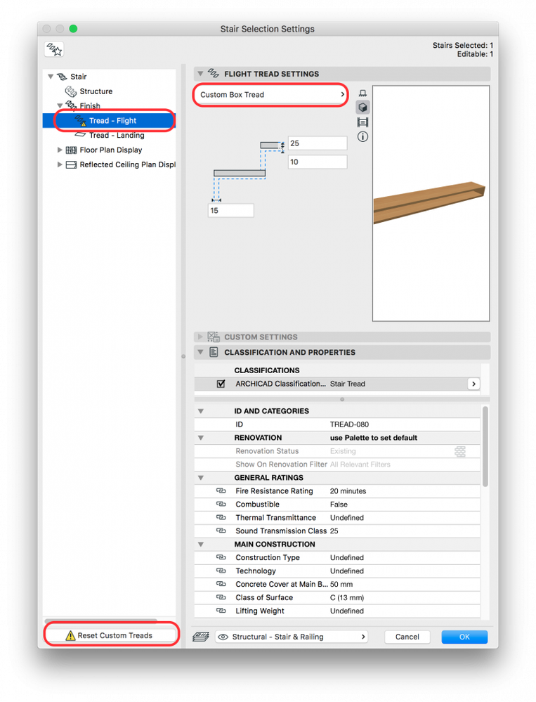

  • Select the Stair and open its setting.
  • Select the Finish › Tread Flight on left and click on the 'Reset Custom Treads' at the bottom of the dialog. This command puts back the missing first step.
  • Now navigate to 'Flight Tread Settings' on the right, click on 'Built-In Tread' and select your custom made Tread.
  • Click ok.
