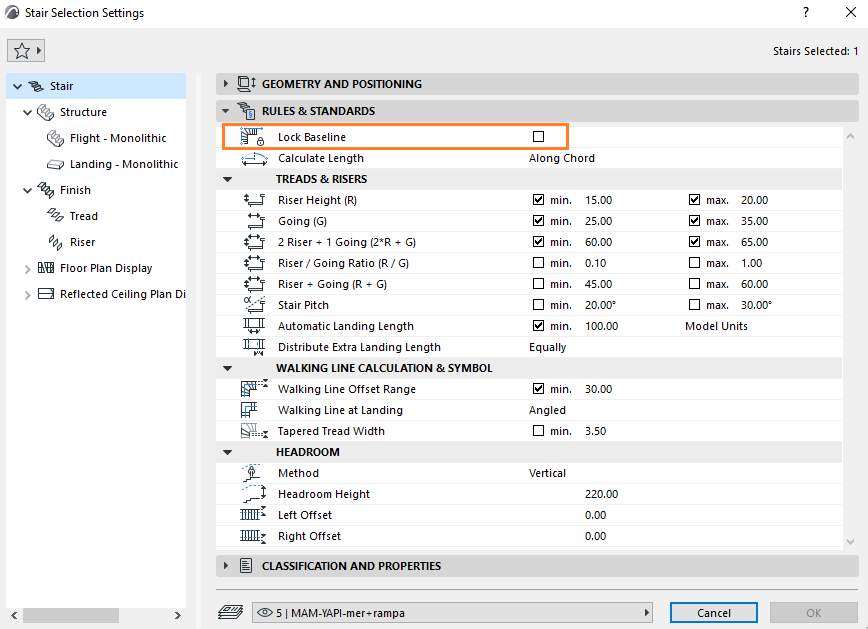

Unlock Baseline for More Flexible Stair Design
Stair design is bound to your concept and many other parameters. Stair flights can automatically stretch or shrink as needed during Stair placement or editing. To enable this, uncheck “Lock Baseline” in Stair Settings.
If you unlock the baseline, flights between turns are automatically selected and unlocked. This extra flexibility helps you avoid impossible geometrical configurations, yet still places unusual stairs without needing the Solver.
This feature is currently available with "Along Chord" calculation method.
