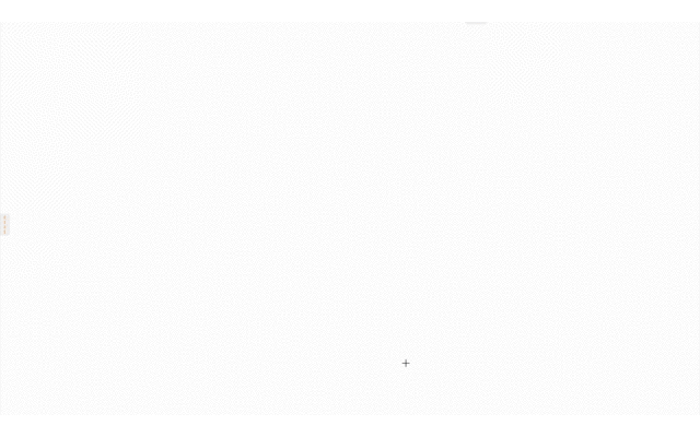

In 2D – Polyline Method

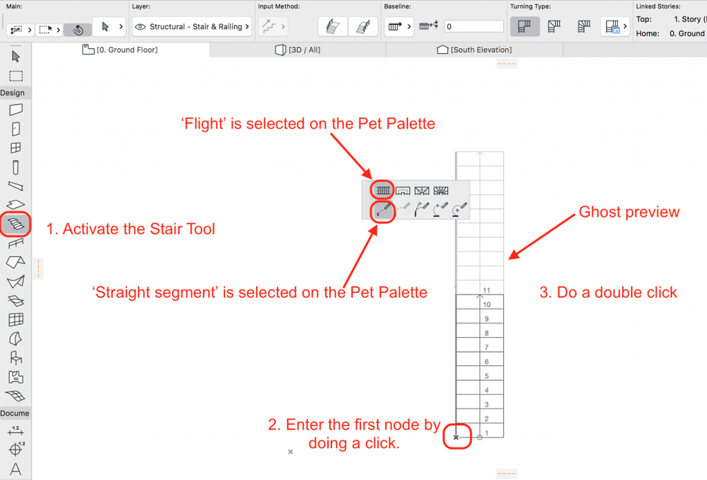

Straight

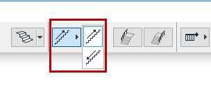

  • Activate the Stair Tool
  • Define the settings of the stair in the Stair Default Settings
  • Enter the first node of the Baseline of the stair (make sure that ’Flight’ is selected in the Pet Palette)
  • Define the end point manually (ghost preview helps you in that)
  • OR do a double click to finish the stair, the second point will be placed automatically

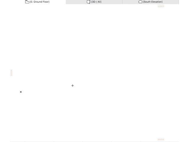

Straight with a Landing
  • Do a click to define the starting point of the landing
  • Activate the ’Landing’ command on the Pet Palette
  • Do a second click for defining efine the end point of the landing
  • Activate the ’Flight’ option on the Pet Palette

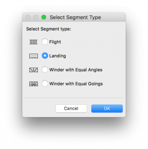

  • Select the Baseline (blue line) of the stair
  • Click on the Baseline
  • Select the ‘Segment Type’ option from the Pet Palette
  • Select ‘Landing’
  • Click Ok.
